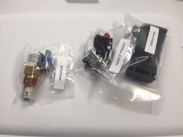

For those that don't know I'm still making plug and play systems for Starquests, they are as close to plug and play as you can get, meaning you can plug in the modified ECU, knock box and distributor into their normal locations, then wire in a new IAT (Intake Air Temperature) sensor and MAP (Manifold Absolute Pressure) sensor.  Both are GM, the MAP is 3-bar and both include connectors that you wire into your existing factory wire harness using the complete instruction provided.  You get:

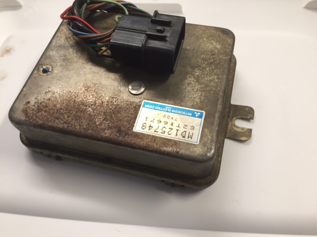

Your ECU back with two connectors hanging out the back, one is a serial connection for communication to your laptop, the other for the rpm input from the distributor.  You also get six feed of two conductor shielded wire with the connector already installed to run through the firewall to the distributor.  A quick splice into the distributor pickup wiring and that's done.

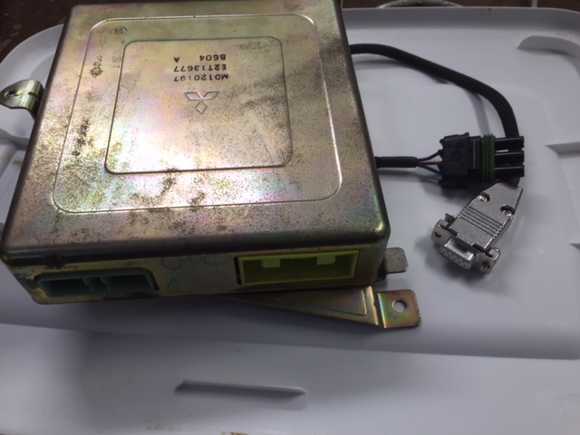

Your knock box back, 88-89 shown but whichever version you have I modify the internals to work with the new ECU and factory coil.

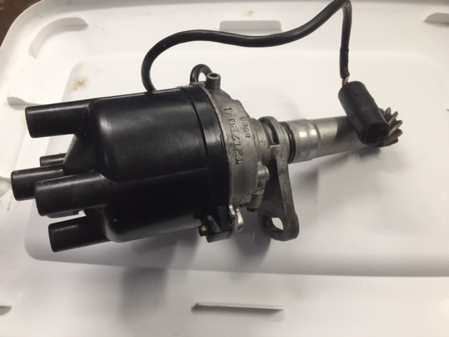

Your distributor, modified.
And the brand new IAT and MAP.
The ECU is the latest version MS2 surface mount board capable of full sequential injection and ignition (with appropriate cam signal, not supplied), electronic boost control, idle valve control, flex fuel, nitrous control and can accept two 0-5V signal inputs that are data loggable.  Examples of that might include fuel pressure, barometric pressure with fuel compensation, oil pressure, cooling system pressure (for those iffy head gaskets) or suspension travel.  It also has CAN (Controller Area Network) which would drive an electronic dash or get sensor data from an I/O extender.
