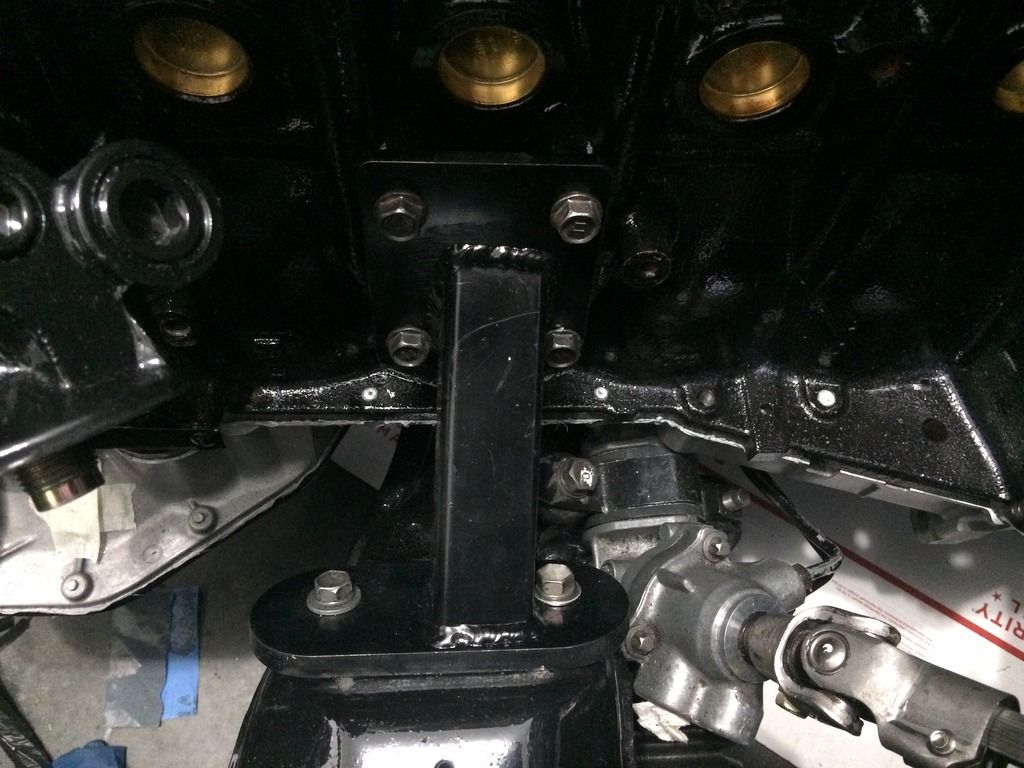

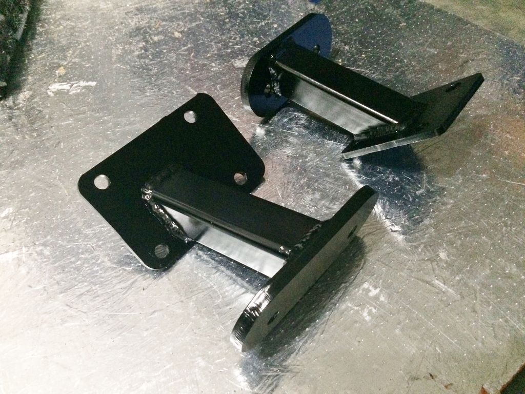

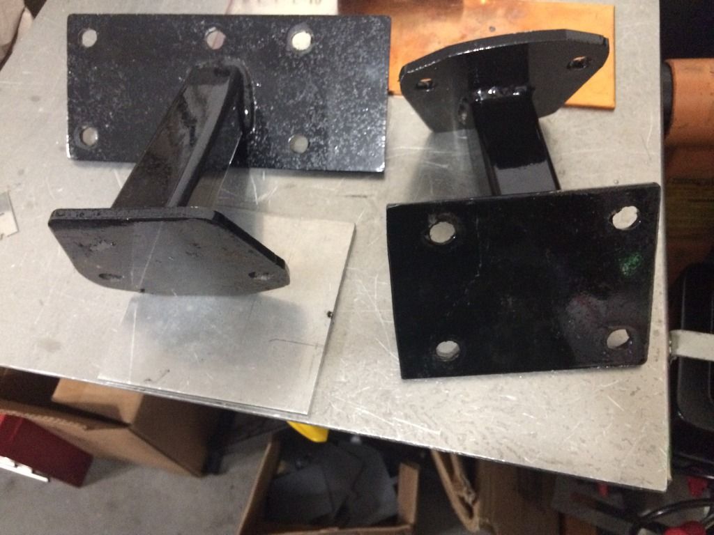

Set one, made by vettekilla.  Construction,  welded steel plates with square tubing.
$220 + shipping and pp fees
Set two, made by me. Construction, welded, laser cut steel plates with square tubing.
Everything double checked for straightness and level engine; on a straight chassis with 2j long block in car.
$240 + shipping and pp fees

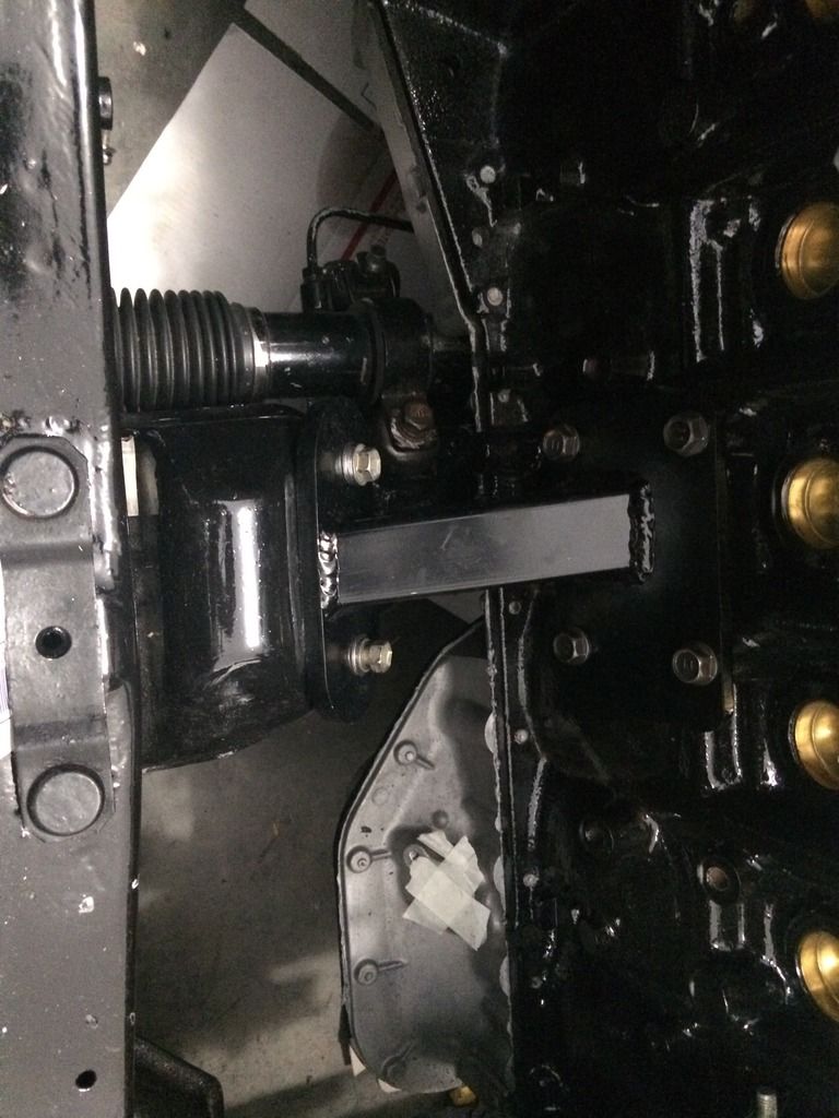

^^^ Yes, 1j and 2j use the same mounts.  I just finished a rack and pinion swap in my 1jz car.  The fitment turned out great.  I just had to slightly sand down the upper oil pan in two places to allow clearance for the hydraulic hard lines on the rack.  I am also using a Saturn SC2 Rack and Pinion.
