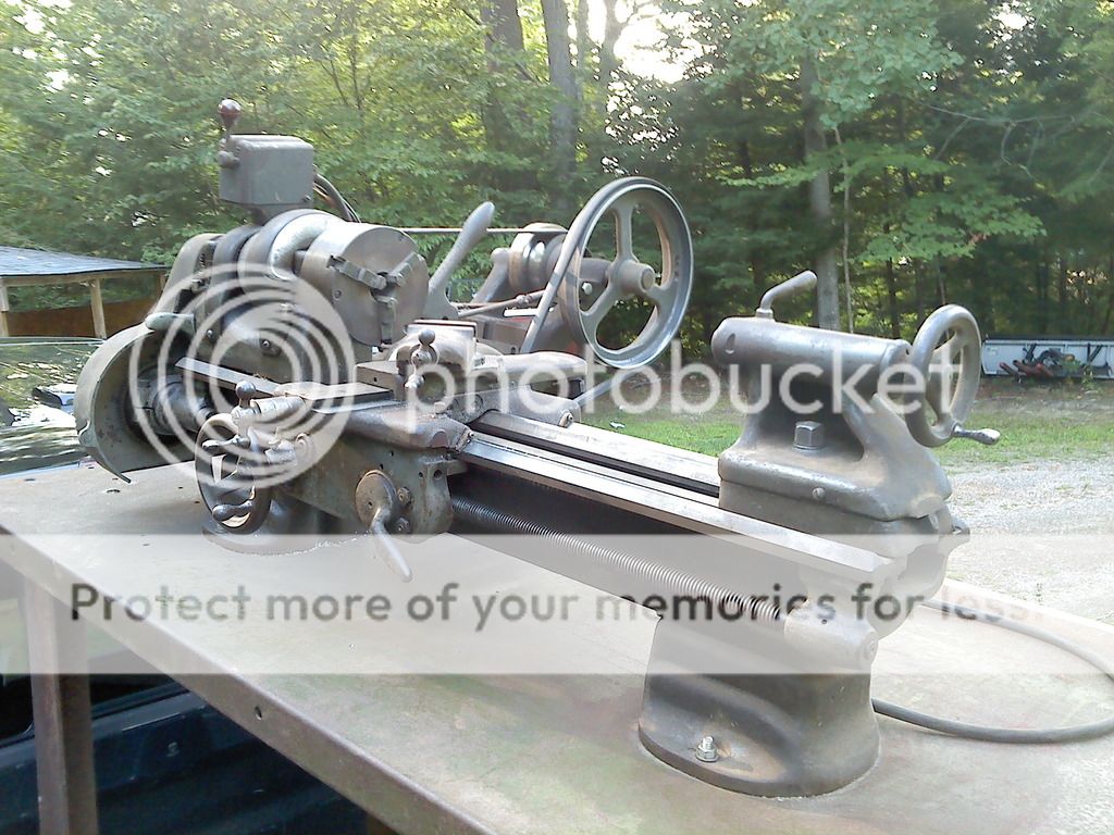

Great news, I'm buying the lathe from my buddy so I'll have it right at my house. Hoping to pick it up this weekend or after work next week. Then the real production work can start!

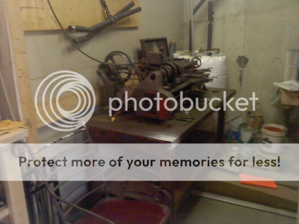

Great news....Lathe is paid for and my buddy and I are moving it into my basement on Tuesday. I plan on turning one for myself then and driving the car for the next week or two with the new bushing, then I can start producing them.

Quick update, the lathe is in my basement now (what a bear to move!!! had to weigh 500lbs including the table...) and operational. Threw the kid in the baby carrier last night and strung some lights up above it, ran extension cords etc...We're in business. I plan on making my bushing today after work if I can get some time to myself and logging some miles on it. My hope is to start running the MK1 production run sometime around the 20th of this month after some real-world testing is complete.

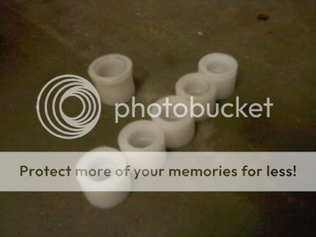

Had a productive last couple hours. Finished setting the lathe up and lubricating everything (no idea how long it's been since that was done) then proceeded to make my first piece.

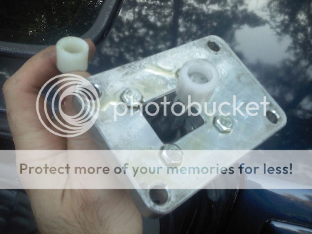

I decided to stay on the simple side at least for this one with no flange on top, basically a copy of the MK1 piece but with more dimensional accuracy. First two pictures are of the lathe in the truck and in its final resting place in my basement, third picture is with my new bushing installed on the shifter and the MK1 one in my hand.
With the dimensions more accurate the shifts/gates are more well defined and have close to 0 slop. Feels like the way it should have been to begin with. I'm gonna put a couple hundred miles on it in the next week with a bunch of hard shifts thrown in there and see how it wears. If I am happy with it by next weekend I'll start producing them for sale then. Thanks for your patience and continued support!

Nice.   Does the delrin feel different in hand than the nylon?  Feel stronger? Harder? It's looks the same....

It actually feels softer to the touch then the nylon, surprisingly. I would think this would lend itself to fewer catastrophic failures which is a lot of what we see with the MK1 bushing--a crack or snapping in half, etc.
The properties aren't too much different between the two but where nylon is brittle (and more susceptible to failure from temperature cycling and chemical exposure) that's kinda what the Delrin was made for. Supposedly more dimensionally stable as well so heating and cooling won't have an effect on the size and it has a long wear life. I can get black Delrin too if you guys would prefer but honestly the pricing is the same, you can't see it and I can't for the life of me figure out the difference other than the color.
I'm gonna put it through its paces this week and report back. As long as it holds up well we're in business.
