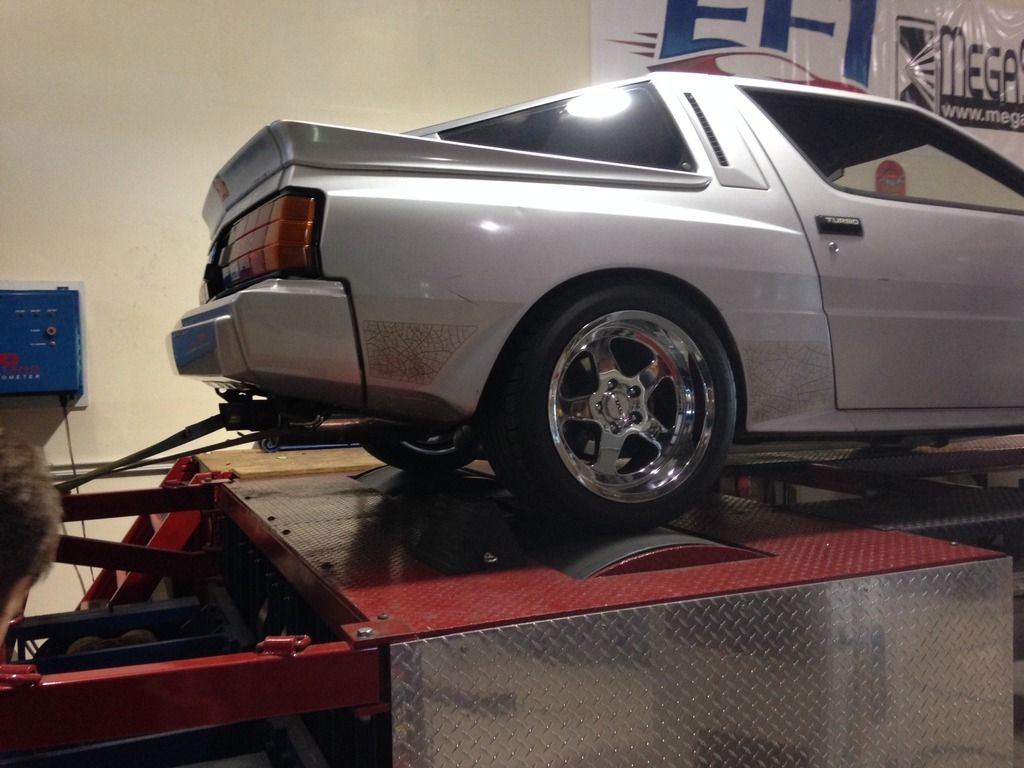

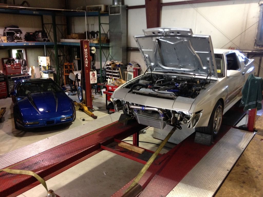

How did the Dyno session turn out?

255whp/305tq @ 17psi
